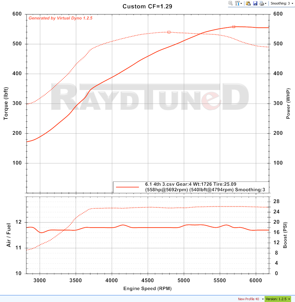

Now i understand that you guys talk BHP, and i've been informed that you guys estimate an average of 18% drivetrain loss in the MPS 6, so for the sake of comparison i've attached a VD containing my latest log (with 2 people in the car) at CF: 1.29 to reflect BHP (assuming 18% drivetrain loss).
My best 60-100mph was 3.93s (was quite a cold night).
I self tuned my MPS for reasons similar to what Justin Heath has, and have since been been offering etuning through my buisness, and quite a few AUS guys have jumped on board for a tune and so far showing some great results! (see results page, however they are all in wkW so might look strange if not use to looking at different units)

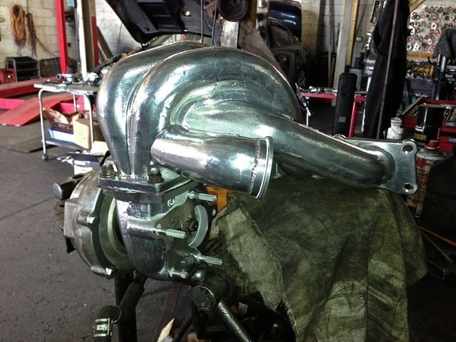

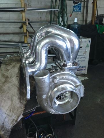

GTX3071 + CPe Exhaust Mani Ceramic Coated

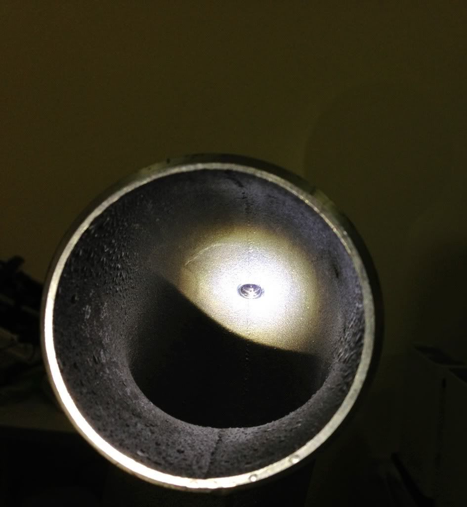

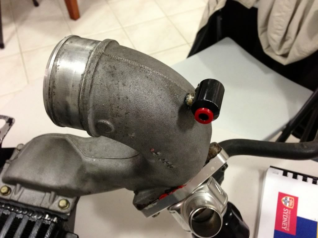

Tapped and fitted DO10 nozzle into intercooler cold pipe near the throttle body entrance[/]

Ignore the WHP on the graph guys, he's worked it out to show bhp. :thumbs:
