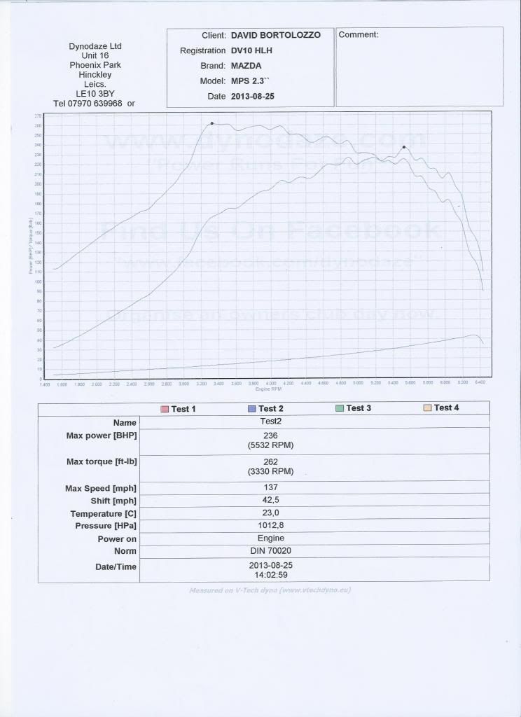

Yesterday I decided to go for a drive out to Dynodaze in Leics and was handed a slightly disappointing readout with bumpy curves after peak torque and up to peak bhp. I'm quite sceptical of this readout as in the past more information has been on the printout, which section would be best to post it in for those in the know?

This is the printout, sorry if this should have been posted elsewhere.
The reason its bothered me is that is doesn't specify whether it is fly or at the wheels, but after looking at the recent dyno printouts from other members on here, power at the wheels would make more sense or I have a fair loss!
However the staff at dynodaze are adamant that they have calculated it to be flywheel power.
And they spelt my name wrong ha!
Ive got the dashcommand app and obd2 plug in but it hasn't automatically validated the PIDs and is giving some enthusiastic numbers to say the least lol.
Upto now im looking at getting the hpfp internals, 2nd cat delete a sure sri and update the recirc valve for now, but must admit im tempted by the sure ventus. Looks like ive already missed out on a few good group buys though lately :rolleyes:

Dont panic, the graph plot has not employed any smoothing factors. All plots come out looking like this without any smoothing.
In terms of the numbers every dyno is different, but a 220whp figure at my local dyno with STD correction to fly wheel - comes out at 265-270hp depending on the air pressure and temperature.

That's great and pretty much what I thought and told them. Thanks for your reply!
Seems that they pi**ed off a few focus RST owners yesterday that have clearly spent a lot of time, effort and money on their cars.
After all it was just an opportunity to have a drive out somewhere, think I'll stick to the dyno I've used in the past or go along to the next MPS RR day for comparison.
Still abit annoying as I would have liked a more accurate starting figure before adding mods to the car.

I'd say the graph looks fairly normal barring the smoothing factors like Pulpmelon said

What gear did they run it in ?
Says max speed was 137

I'm pretty sure it was ran in 5th. Sorry if my reply's don't match up to your post, my reply's are being moderated prior to being shown.

5th is fine, it's actually closer to 1:1 than 4th. Graph looks good, it's probably whp. Post some logs to be sure.

Hi Dario, don't worry about the figures, it's quite widely known around Leicester that you come out with 30bhp less at dynodaze compared to anywhere else. Last time I was there an ST had done about 1k worth of mods since the last time he was there and he'd lost 2bhp haha
