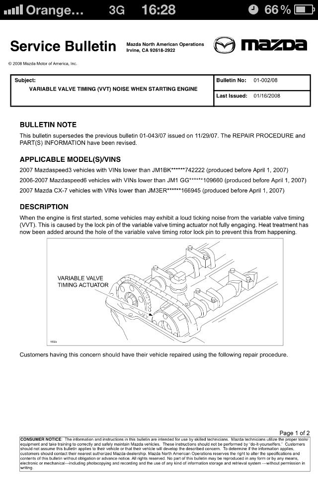

@spamdo you mention the vvt 'recall' was it a recall or just an issue on some cars?

t was never a recall - not enough cars to warrant it. There's just a handful of cars that have assploded because of it is all :)
That's America mate and not a UK recall.

Those bulletins about the VVT issues, was it more common on the early models then? As I said before I'm on the lookout for a cheaper tax one, so it could quite likely be an issue on one of them?... I guess some have been ok though?
Definately need to check if the repair has been carried out on whatever I buy then!

If the vvt issue develops its a £780 fix from xopower so its not terrable but it would be nice if its been done already.

VVT failure is very low, I'd guess about 5%.... but good to be aware of it. Easy to get a screwdriver or whatever and press against area and listen - however a timing chain hitting rocker cover around about oil cap area should be obvious enough.
