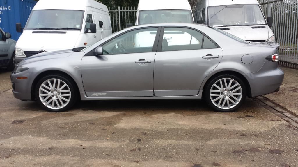

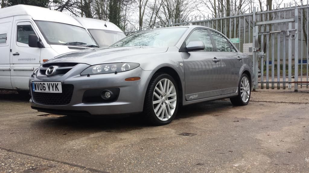

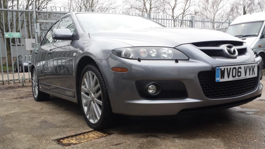

Here are some pics hope to get to a meet at some point and learn more about these great cars
