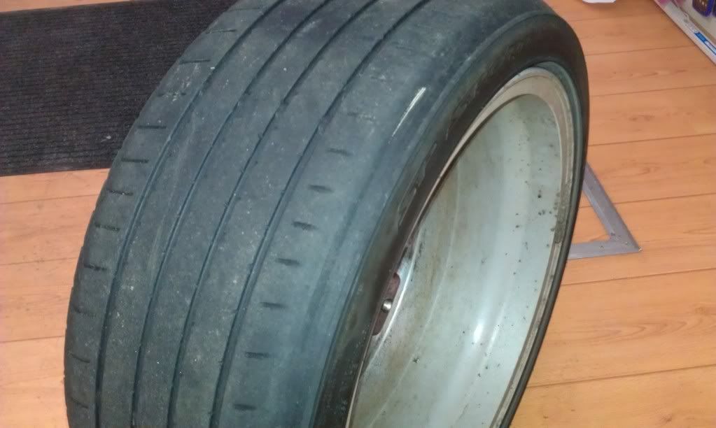

This is my Front Left tyre, of my old stock Dunlops, now replaced with Michelin PS3's.
Same excessive wear on the inner and outer, and you can even see the rubber has totally gone from one part. i reckon i got around 10k give or take. Wouldn't have noticed this if i didn't get a blow out on boxing day!
pretty sure you get points for this kind of wear! i check my regularly now!

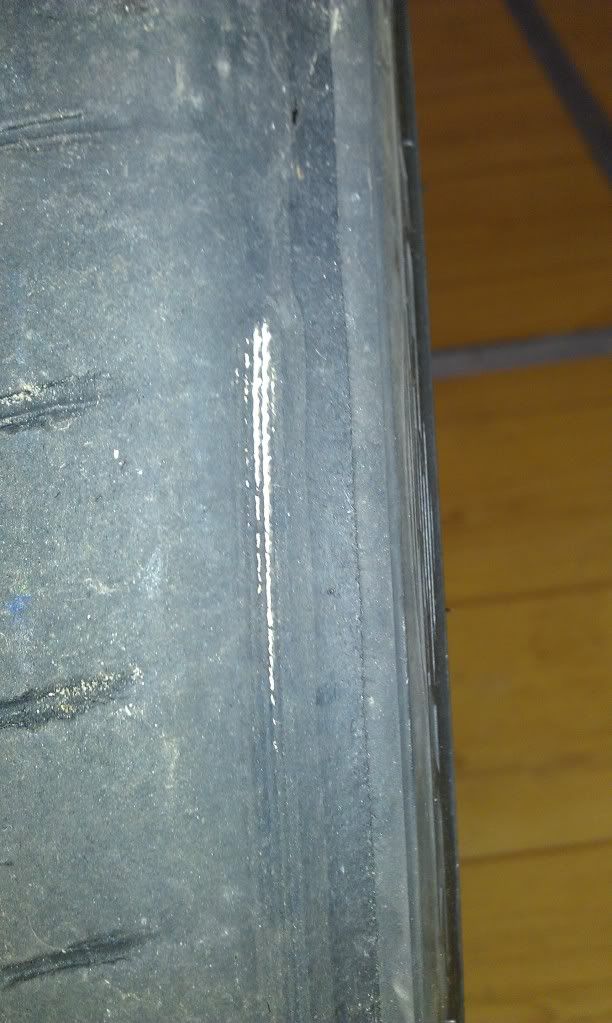

First time on in a while... well after me originally posting this thread, I have become the latest victim. Drivers side front inner wear that is absolutely terrifying!!!
11,400 miles done, so around about the same level as the customer that was in at my brothers work last year. The strange thing is that the passenger side is even on the inside and outside and although worn, not what I would say to excessive levels and would last me until my MOT/ service in March. Apologies for the poor pics as taken on iphone with tyre still on car.
I had been checking the tyres regularly, but with being very busy over xmas & new year had maybe gone 6 or 7 weeks without inspecting the inside wear. I am very fortunate not to have had a blow out in that time. I do not believe a tyre should suffer a wear pattern like that though at just over 11,000 miles.
